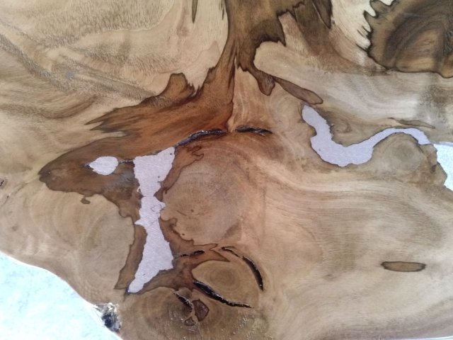

Post by nikola28 »
Mozda gresim,ali nisam primetio da kontakti na stamapanim plocama oksidiraju...malopre sam pokusao pa sam topio kalaj plinskim brenerom,visak sam skinuo smirglom,ispalo je ekstra!

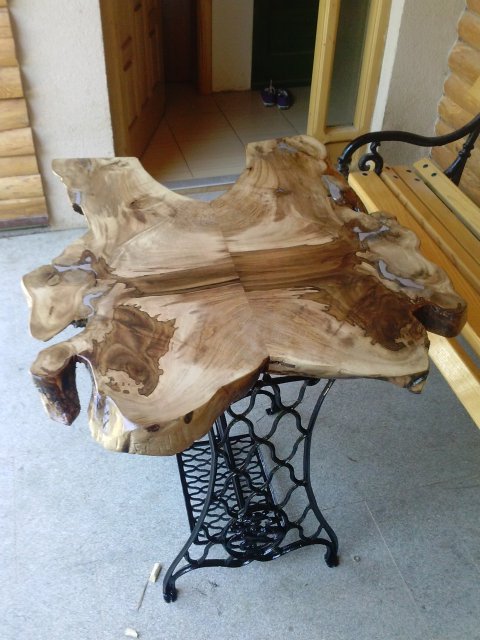

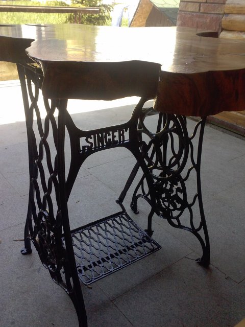

Post by nikola28 »
nikola28
Posts: 566
Joined: 22 Jun 2010 18:40
Location: Lazarevac
Post by nikola28 »
nikola28
Posts: 566
Location: Lazarevac
Post by nikola28 »
