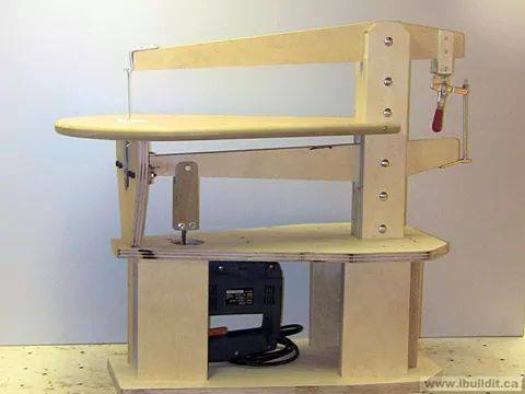

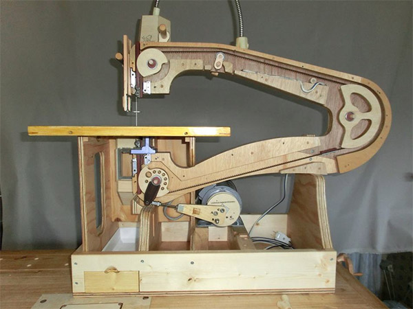

Drvorad
Posts: 49
Joined: 17 Nov 2013 20:55
Location: Arandjelovac
Post by Drvorad »
Evo jos jedna drvena:hurra:
Ima ih jos, vidjao sam ih cak i na pedale kao biciklo. Kod njih nema problema sa regulacijom brzine:tummenupp:
peradetlic
Posts: 912
Joined: 06 Mar 2009 20:50
Location: Baranda-Ils
Post by peradetlic »
aaaaa ovo bansek nije scrol saw
