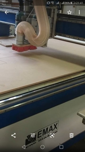

maricaiivica wrote:Za mene, vrhunac tehnologije u pomenutog proizvodjaca.
U pitanju su testere, i to dve, za obe ose po jedna
:oskyldig:
[url]http://www.stolarskaradionica.com/forum/uploads/thumbs/1350_screenshot_20200225-213601.jpg[/url]
[url]http://www.stolarskaradionica.com/forum/uploads/thumbs/1350_screenshot_20200225-214142.jpg[/url]
Ako vide ovi iz Makite, tuzice ga, garant !!! :D:D:D
